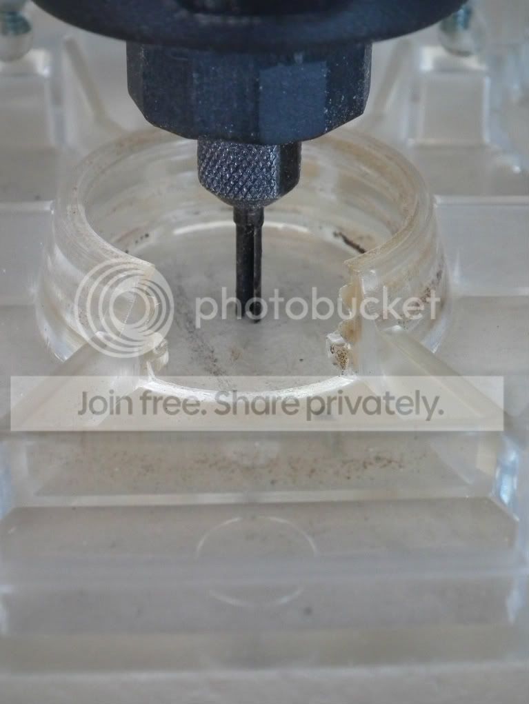

The first pass will be done with the 1/8” cutting bit #650. This is a very aggressive bit and should only be used for the initial one or two passes. Start by finding the surface of the wood and noting it on the guage marker below the depth lock knob. Then plunge the bit to your desired depth and lock down. As with turning or milling consider ‘Speed and Feed.’ In this case the speed/RPM’s of the variable speed bit dictates how fast you can move the router at your chosen cutting depth through the wood. Because the barn wood is aged and warped I take a very shallow cut (approx. 1/64” to 1/32”) for the first pass just to remove the aged top surface at a uniform depth.
04 Bit #650
04 Flush to Surface
